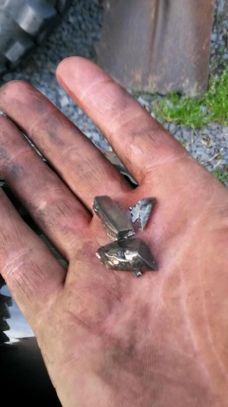

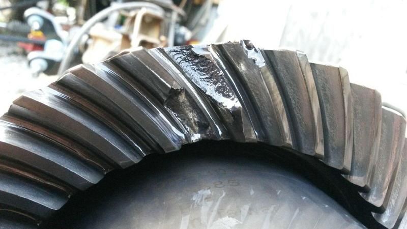

The Pro Rock 44 wasn't ordered just for the purpose of upgrading. I knew I had some issues in he front end. I've had a speed based noise when in 4 wheel drive (sounded like vibration but wasn't felt like you would expect from the sound). A front Driveshaft failure was expected so I had a driveshaft on standby. When the sound/vibration was first noticed, I just wrote it off as the front driveshaft taking a dump on me so no big deal.
Driveshaft didn't fix the noise and there was a mildly noticeable sound even with the front driveshaft out. I was pretty sure I had a R&P issue but still had room for improvement on the pinion angle. The Pro Rock 44 Unlimited addressed both...
Got the 30 pulled and popped the cover on it today...
Not really sure about the cause. I don't think I was too hard on it but there have been a few times that I've put a decent load on it. Not sure if it's a defect, setup issue, Just broke, or if the Q78s were harder on it than I thought.
